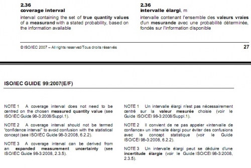

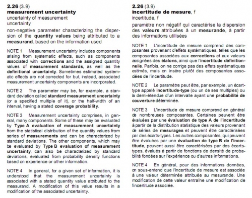

回复 26# 刘彦刚
现将VIM3涉及不确定度与真值关系的条款(这些条款2012版与2008版相同),复印如下,不是打字,而是复印,保证不错一个符号。令人惊讶的是,在《JJF1001-2011》中居然回避“真值”二字,把“真值”改为“量值”。此事发生在信仰辩证唯物论的国度里,岂非咄咄怪事。要注意,VIM2008版问世三年后,JJF竟然如此,这就不全是迷信洋人的问题了。我们不禁要说:做为《JJF1001-2011》主要起草人的第一人的叶德培先生,国际规范都不得不承认的真值,你(们)竟敢抹掉,太放肆了!
2.26 (3.9) measurement uncertainty
non-negative parameter characterizing the dispersion of the quantity values being attributed to a measurand, based on the information used
NOTE 1 Measurement uncertainty includes components arising from systematic effects, such as components associated with corrections and the assigned quantity
values of measurement standards, as well as the definitional uncertainty. Sometimes estimated systematic effects are not corrected for but, instead, associated measurement uncertainty components are incorporated.
NOTE 2 The parameter may be, for example, a standard deviation called standard measurement uncertainty (or a specified multiple of it), or the half-width of an interval, having a stated coverage probability.
2.36  coverage interval
interval containing the set of true quantity values of a measurand with a stated probability, based on the information available
NOTE 1 A coverage interval does not need to be centred on the chosen measured quantity value (see JCGM 101:2008).
NOTE 2 A coverage interval should not be termed “confidence interval” to avoid confusion with the statistical concept (see GUM:1995, 6.2.2).
NOTE 3 A coverage interval can be derived from an expanded measurement uncertainty (see GUM:1995, 2.3.5).
2.37 coverage probability
probability that the set of true quantity values of a measurand is contained within a specified coverage interval
NOTE 1 This definition pertains to the Uncertainty Approach as presented in the GUM. NOTE 2 The coverage probability is also termed “level of confidence” in the GUM.

    在“non-negative parameter characterizing the dispersion of the quantity values being attributed to a measurand, based on the information used.”中,好象看不出回避“真值”二字,把“真值”改为“量值”哦!

但叶先生是不识时务,当今的不确定度的标准解释应该是VIM32008版与2012版的解释。不确定度是包含真值的区间的半宽。把我上传的几段英文的大字部分连起来,就是:不确定度是包含区间的半宽,此区间以一定概率包含真值。
但是,叶德培先生起草(第一起草人)的JJF1001-2011,明明是翻译(当然是翻译VIM2008版,不可能翻译2012版),却把原文的“真值”改成量值,这是很错误的。外国人都已认识到不能离开真值,而中国的JJF却回避真值,这可是哲学思想上出了问题。
把三段英文的讲真值,和JJF1001-2011的相应条文(5.1825.285.29)对比一下,就可看出问题。
例如 VIM3 的讲究真值的写法为:
JJF1001-2011 的条款是:
5.28 包含区间 VIM2.36
基于可获得的信息确定的包含被测量一组值的区间,被测量值以一定概率落在该区间内。
英文原文是被测量的真值组,中文却改为被测量一组值。这是明目张胆的篡改!明明注着此条等效于VIM2.36 ,而原文有“真值”,中文规范却回避了。

史老:你发现不仅是JJF1001-2011与VIM3有不同,其实从字面上看就这三个定义VIM3自身也出现了不同!
VIM3不确定度定义里说的是被测量量值:
VIM3包含区间和概率定义里说的是被测量的真值:
 楼主| 刘彦刚 发表于 2014-3-6 04:29:59 | 显示全部楼层
回复 39# 史锦顺
    我想VIM并列给出的是法文吧?不是说法文最严谨,为了防止出现歧义,国际上重要的文件都要在用英文表达的同时,再用法文表达一遍。要有量友能懂法文就好了,也许我们就能帮VIM修正个错误!
史锦顺 发表于 2014-3-6 09:00:22 | 显示全部楼层
回复 43# 刘彦刚
其实,查几个关键词,就会知道,在真值问题上,英文本与法文本没有区别。注意,法文词序常常与英文词序相反。在词序上,英文像中文,而法文与中文相反。中文英文都是“真-值”而法文是“值-真”。
     法文------------英文----------------中文
         Varies----------- true------------------
         Valeurs---------values---------------
  valeurs vraies-----true values---------真值

  JJF1001-2011的3.21条“量的真值”定义注3说“其中‘真’字被认为是多余的”,所以我认为在讨论不确定度定义时,“被测量的真值”、“被测量(的)量值”、“被测量值”其实是一回事,都是指符合被测量定义的真实的值,即“被测量真值”,没必要在这个问题上去多费脑筋。
